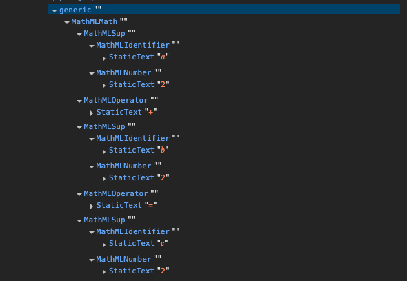

With this approach, the accessibility tree shows good semantics and VoiceOver knows well what to do.
Accessibility tree view of a MathML formula showing nested semantic elements. The tree includes nodes such as MathMLMath, MathMLSup, MathMLIdentifier, MathMLNumber, and MathMLOperator, representing the structure of the equation a² + b² = c².
However, as we will see throughout the article, screen reader support for the math tag varies across assistive technologies. VoiceOver seems to be doing a pretty good job, JAWS also makes it easy for both speech and braille, and NVDA needs an add-on to make it work called MathCat because if not, the math tag will be ignored. A major pull request (#18323) was merged on 17 November 2025 which integrates MathCAT into NVDA core, meaning users won’t have to find/install a separate add-on to handle math.
